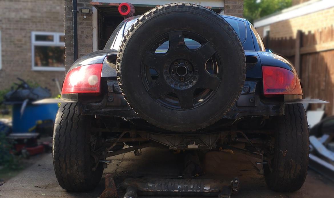

Quick video this week - a rear suspension lift. Rear spring spacers made from Land Rover spring seats.
Now it sits at the right height at last, instead of riding like there's a tonne of cement in the back end. Well, or a tonne of anything - you get the point.
Video here: https://youtu.be/3Zjtl4vsX5E

Patrick (Forum Supporter)
Patrick (Forum Supporter) MegaDork
6/6/20 9:58 a.m.
The rear mount spare is perfect
DaveMakesStuff
DaveMakesStuff New Reader
6/6/20 1:10 p.m.
In reply to Patrick (Forum Supporter) :
Thankyou :) I think the low angle flatters it a bit, but I didn't want to put it on the roof and there weren't too many other options...
