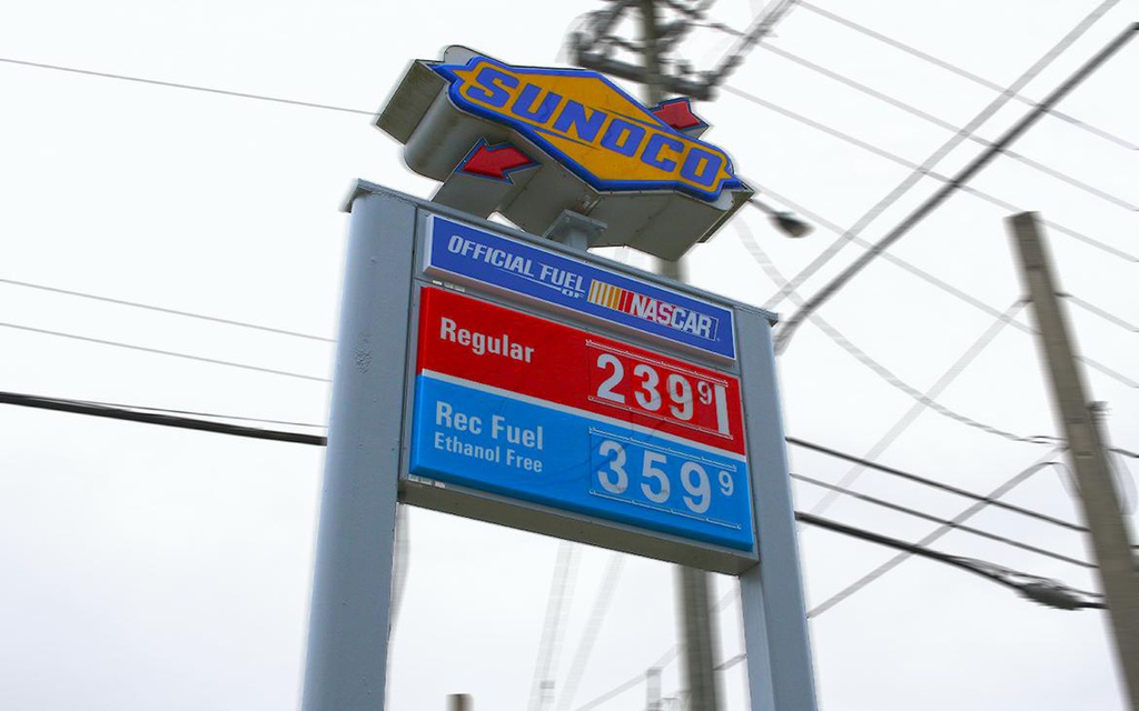

Sponsored Content Presented by Sunoco Race Fuels.
Is that 10% ethanol found in most pump gasoline good or bad for your classic? Like many things in life, it’s complicated.
