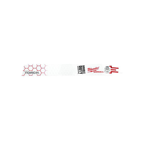

Slow down, don't force it, and use these. I get pretty darn good results. at least on par if not better than my abrasive chop saw (which also requires much more finishing after the cut).  Maybe I'll look into a portaband though if they are really that much better.
