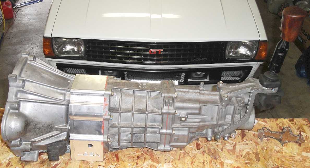

Jan. 31
just about ready for the 6 speed
Here is the Toyota J160 with LEEN adapter fitted, and just about ready for installation. …
