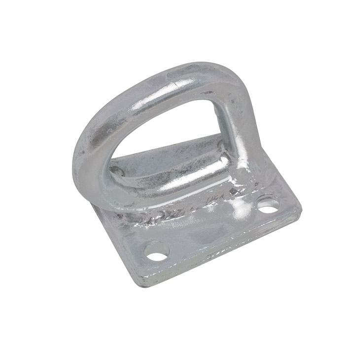

This is a tow hook:
This is a novelty item:
