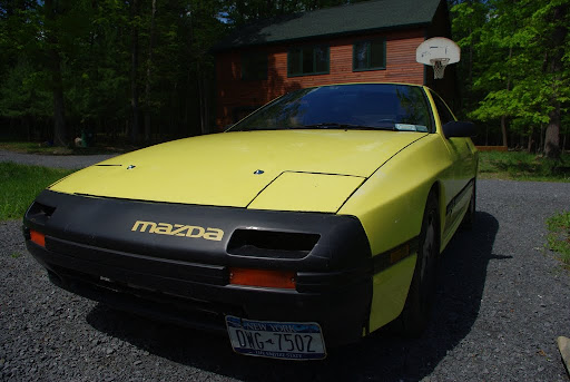

I found this car in New Paltz, NY on the RX-7 Club. I might go see it this weekend. The owner wants $3000 for it, plus it's titled and streetable. He says it was very fast at a recent autocross event and drives fine. It looks ugly-but-legit, however, I would like the GRM take on it since turbo rotaries are so finicky and swaps can be botched.

It looks ugly? I think it looks pretty cool, maybe paint the bumper to match though.

"Car was originally gold." Now Flacco yellow. That's a shame .
Pipe work looks neat enough...if that's any indication as to the quality of the swap, or not.

I mean, T-bolt clamps, Vibrant couplers, (apparently) good welds on the charge piping, double-sheave alternator pulley. If you can get a rotary compression tester on it to verify engine health, I'd say it's worth $3K. Looks like it was pretty well done.

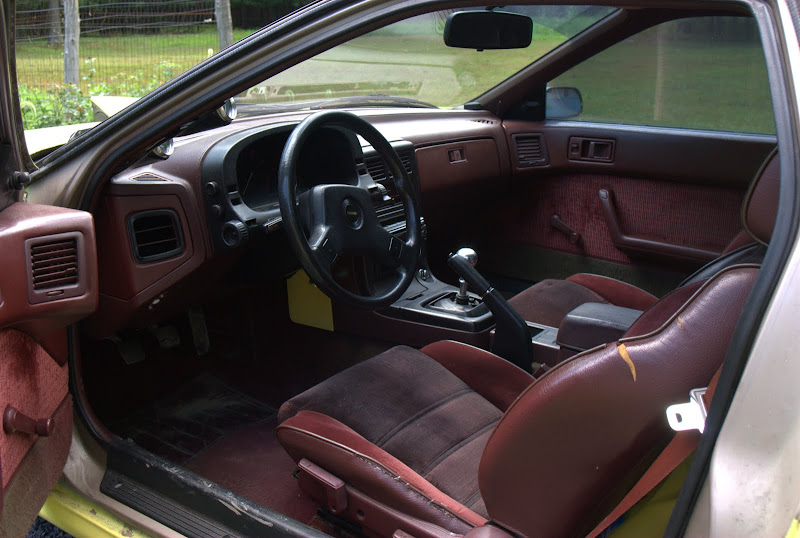

Man it still has those unobtanium dash vents.....careful with those, I've heard of them shattering sliding off a textbook onto a table, as in a 2" maybe drop, bits and pieces. Looks good though, Turbo rotaries are nuts. Looks like a stock radiator, I would change that out in a hurry if you plan on keeping it long, If it even thinks about starting to get warm, shut it down. Good luck

I took a look at the car today and took it out for a spin. It is FAST- I think it's faster than my MS3. Not having a TPS hooked up to the ECU means the engine stalls if you don't rev it up to at least 3000rpm when clutching out. BTW, that OS Giken clutch is heavy and it's hard to tell the engagement point. I think I stalled that car more times during the test drive than I've stalled any other manual car in my lifetime. I'm wondering if there were any way I could get the FD3S TPS to talk to the S5 ECU (i.e. adding a resistor) as a temporary measure, as this car needs some sort of aftermarket ECU.
Spinout007 and Racer_Ace, you are right about those cooling parts: It's a stock S4 radiator, FAL fan (minus the shroud) and the upper radiator hose is poorly designed. The fill cap on the radiator hose is not at the highest part of the cooling system. EDIT: This is because the S4 cooling system had the fill cap on the thermostat housing, while the S5 cooling system has the fill cap on the radiator. An S5-specific radiator might solve this issue. The FMIC is huge and looks like it blocks some of the airflow to the radiator. In its current state, it would not survive the trip back to MA w/o overheating. I'm going to speak to my friend who has an tuned 10th Anniversary Edition turbo how his cooling system is set up and if he has his FMIC in front of the radiator or if he has a different setup (i.e. a V-mount).
The body has almost no rust and already has an aluminum hood. Stock bushings and DTSS. It needs front left wheel bearings and an alignment. Has the typical S4 electrical maladies (horn doesn't work so a new one was jury-rigged, wipers only work at one speed, etc.). I've dealt with all of that before with my current S4 and it just requires some soldering to fix. I didn't hoon it too hard, but the KYBs/Eibach springs rode well- they felt like the Konis on softest settings/stock springs on my current FC.
So, I'm not sure. I told the owner I'd have an answer on Wed. The cooling gives me pause. If it were up to the level of the rest of the car I would have bought it. The current owner and the previous owner (who was there today and actually built the car) have offered to trailer the car back to MA if I decide to buy it for the offer price of $3000 and to remain in contact with me via e-mail if I run into any snags. The person who built the car spent over $8000 to get the car to where it is today.
